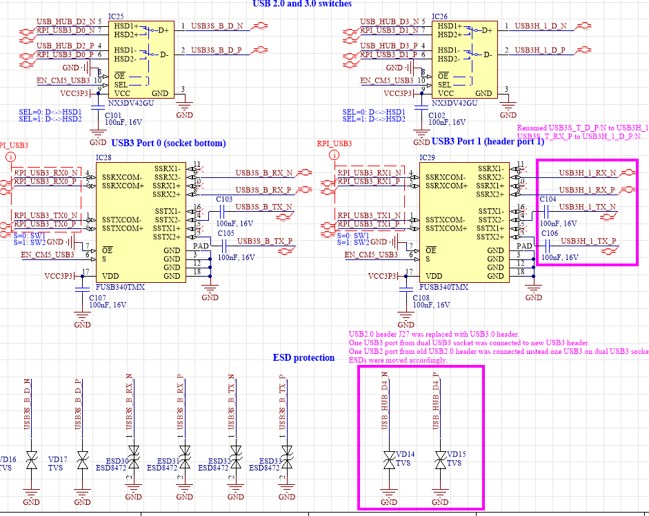

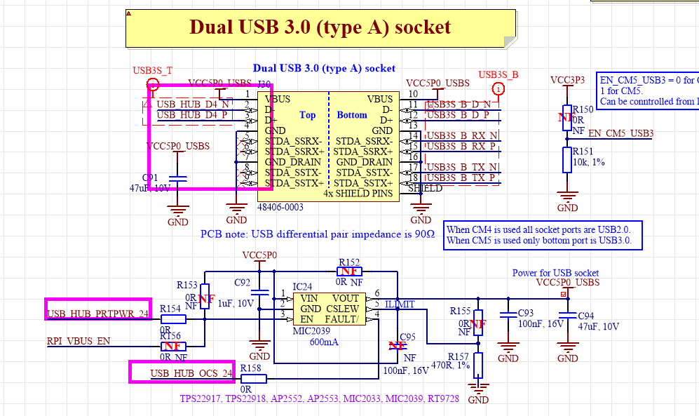

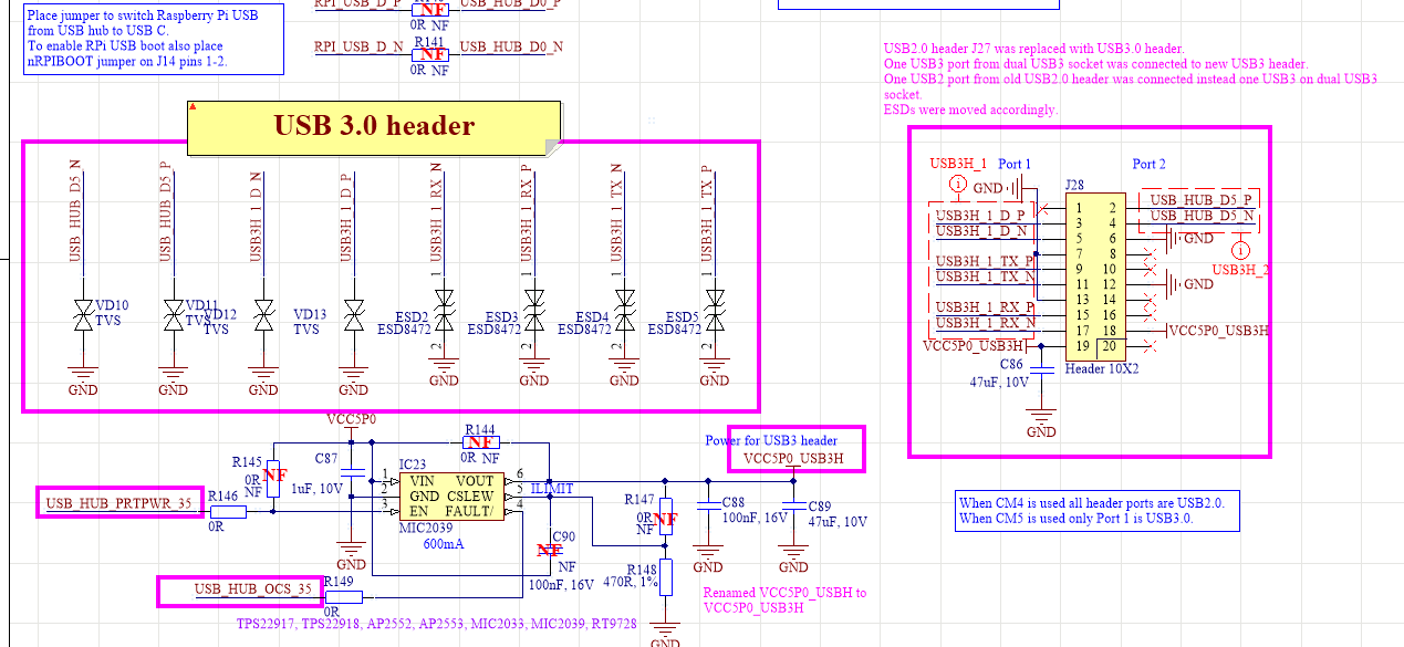

    • Dual USB 3.0 (type A) socket (downstream ports) or Front Panel USB 2.0 header (unpopulated)

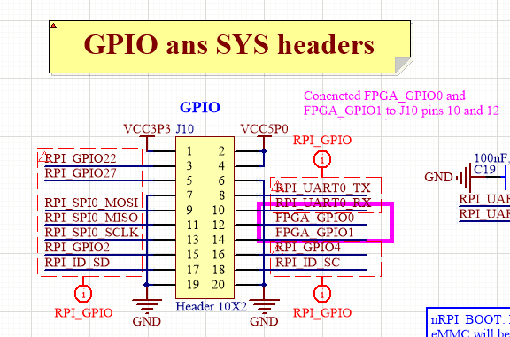

    • 20-pin Raspberry CM4 GPIO header (3.3V)
    • 14-pin Raspberry CM4 SYS header

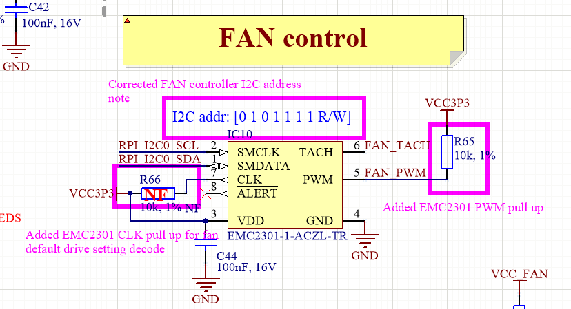

    • 2-pin and 4-pin FAN connector (5V default or 3.3V or VCC_INT voltage)

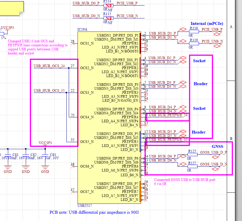

    • o FPGA Lattice iCE40 Ultra family (iCELP4K)
    • Board temperature sensor
    • FAN controller
    • EEPROM
    • Secure key storage, I/O expander
    • RTC, ADC
    • USB 2.0 hub

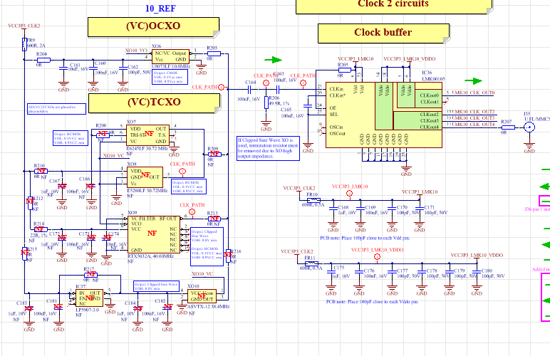

  • Clock system:
    • GNSS receiver
    • 30.72MHz and 10 MHz (default) on board VCOCXOs and 30.72/38.4/40.00MHz (optional) VCTCXOs
    • Possibility to tune on board XO by on-board DAC or by phase detector to match a reference clock input (e.g. 10MHz).

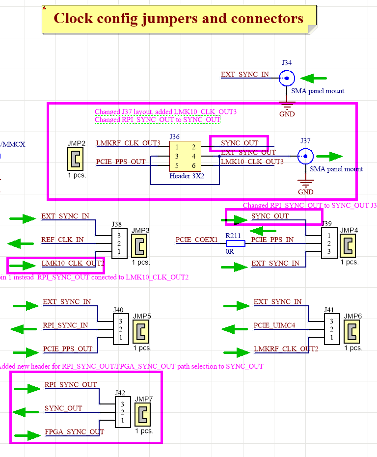

    • Reference clock/PPS input and output SMA connectors (EXT_SYNC_IN and EXT_SYNC_OUT)
    • Possibility to synchronize multiple boards using coaxial SMA connectors (EXT_SYNC_IN and EXT_SYNC_OUT)

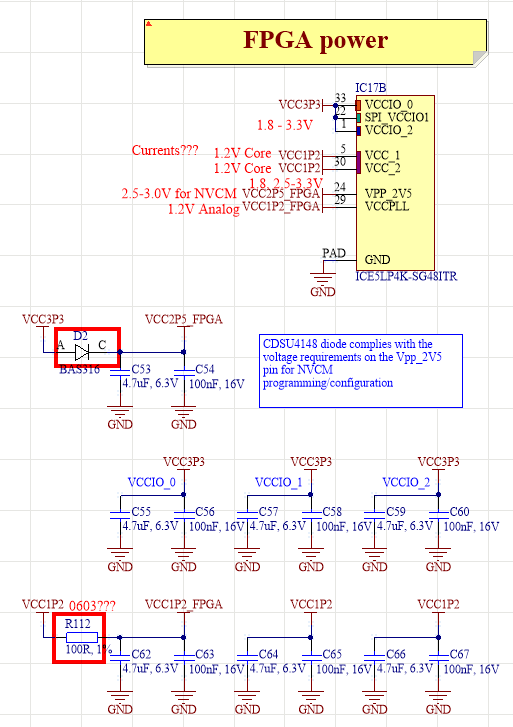

FPGA

USB2.0 HUB
IC20, IC25, IC26, IC28, IC29
IC
USB switch

J10
Header
20-pin CM4 GPIO header

USB
USB 2.0 (Type-C) socket
J30
USB
Dual USB 3.0 (Type-A) socket

Clock Circuitry
XO1
VCOCXO
30.72 MHz VCOCXO
XO6
VCOCXO
10 MHz VCOCXO
XO2, XO7
VCTCXO
30.72 MHz VCTCXO
XO3, XO8
VCTCXO
30.72 MHz VCTCXO
XO4, XO9
VCTCXO
40.00 MHz VCTCXO
XO5, XO10
VCTCXO
38.40 MHz VCTCXO
IC40
IC
GNSS receiver
IC33 (IC35)
IC
16 (8) bit DAC for XOs VC tuning
IC39
IC
RPi sync mux

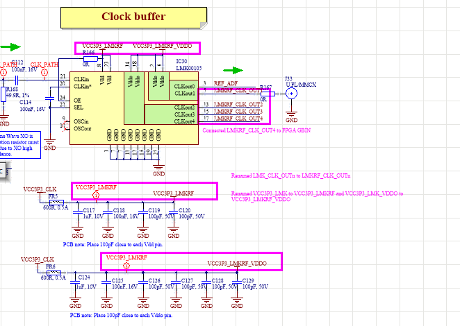

IC30, IC36
IC
Clock buffer
IC34
IC
Phase detector
J34
SMA connector
Reference clock input EXT_SYNC_IN
J37
SMA connector
Reference clock output EXT_SYNC_OUT
J33, J35
U.FL connector
J22/J20, J21
Multiple
Internal connector J20/J22 to external SMA J21
J44
U.FL connector
External GNSS antenna

IC57
IC
Switching regulator ADP2386 (3.3V rail)
IC58
IC
Switching regulator ADP2386 (5.0V rail)

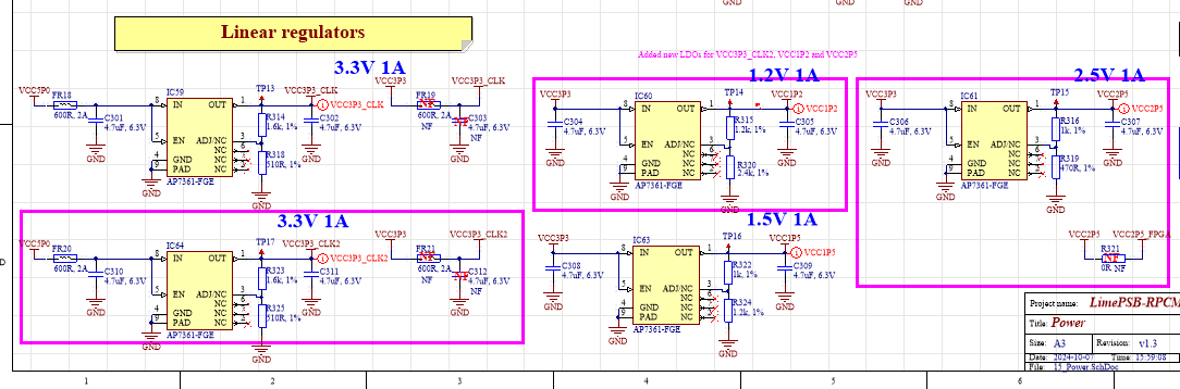

IC59, IC64
IC
Linear regulator AP7361-FGE (3.3V rail)
IC61
IC
Linear regulator AP7361-FGE (2.5V rail)
IC63
IC
Linear regulator AP7361-FGE (1.5V rail)
IC60
IC
IC62
IC
Voltage reference AS431ANTR-G1 (2.5V rail)

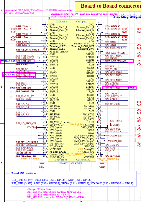

Raspberry CM4/5 Connector
LimePSB RPCM board is designed to use Raspberry Pi CM4/5 as a host computer. Raspberry Pi CM4/5L version without eMMC Flash memory is also supported. Board to board connectors (J1 and J2) are used to connect CM4/5 to the LimePSB RPCM board. Connector pinout, CM4 and CM5 signals and schematic signal names are listed and described in Table 2.
Table 2. Raspberry Pi Compute Module 4 connector pinout
CM4 Pin
CM4 reference
Schematic signal name
Description [1]

GPIO_VREF
VCC3P3
GPIO reference voltage
79
+5V (Input)
VCC5P0
4.75V-5.25V. Main power input
80
SCL0
RPI_I2C0_SCL
I2C clock pin
81
+5V (Input)
VCC5P0
82
SDA0
RPI_I2C0_SDA
I2C Data pin
83
+5V (Input)
VCC5P0
84
CM4_3.3V (Output)
VCC3P3_RPI
3.3V ± 2.5%. Power Output
85
+5V (Input)
VCC5P0
86
CM4_3.3V (Output)
VCC3P3_RPI
87
+5V (Input)
VCC5P0
88
CM4_1.8V (Output)
VCC1P8_RPI
1.8V ± 2.5%. Power Output
89
WL_nDisable
RPI_WL_nDISABLE
Wireless interface disable
90
CM4_1.8V (Output)
VCC1P8_RPI
91
BT_nDisable
RPI_BT_nDISABLE
Bluetooth interface disable
92
RUN_PG
RPI_RUN_PG
CM4 CPU reset/power good
93
nRPIBOOT
RPI_nRPIBOOT
booting from an RPI server
94
AnalogIP1
RPI_AIP1
Analogue input
95
PI_LED_nPWR
RPI_LED_nPWR
Power On LED
96
AnalogIP0
RPI_AIP0
Analogue input
97
Camera_GPIO
CAM1_GPIO0
Used to shut down the camera
98
GND
GND
Ground (0V)
99
GLOBAL_EN
RPI_GLOBAL_EN
CM4 enable
100
nEXTRST
RPI_nEXTRST
Output. Driven low during reset
101
USB_OTG_ID
RPI_USB_OTG_ID
USB OTG Pin
102
PCIe_CLK_nREQ
RPI_PCIE_CLK_nREQ
PCIe clock request
103
USB_N
RPI_USB_D_N
USB D-
104
Reserved
NC
Do not connect
105
USB_P
RPI_USB_D_P
USB D+
106
Reserved
RPI_PCIE_DET_nWAKE
Do not connect
107
GND
GND
Ground (0V)
108
GND
GND
Ground (0V)
109
PCIe_nRST
RPI_PCIE_nRST
PCIe reset
110
PCIe_CLK_P
RPI_PCIE_CLK_P
PCIe clock Out positive
111
VDAC_COMP
RPI_PIN11
Video DAC output
112
PCIe_CLK_N
RPI_PCIE_CLK_N
PCIe clock Out negative
113
GND
GND
Ground (0V)
114
GND
GND
Ground (0V)
115
CAM1_D0_N
CAM1_D0_N
Input Camera1 D0 negative
116
PCIe_RX_P
RPI_PCIE_RX_P
Input PCIe GEN 2 RX positive
117
CAM1_D0_P
CAM1_D0_P
Input Camera1 D0 positive
118
PCIe_RX_N
RPI_PCIE_RX_N
Input PCIe GEN 2 RX negative
119
GND
GND
Ground (0V)
120
GND
GND
Ground (0V)
121
CAM1_D1_N
CAM1_D1_N
Input Camera1 D1 negative
122
PCIe_TX_P
RPI_PCIE_TX_P
Output PCIe GEN 2 TX positive
123
CAM1_D1_P
CAM1_D1_P
Input Camera1 D1 positive
124
PCIe_TX_N
RPI_PCIE_TX_N
125
GND
GND
Ground (0V)
126
GND
GND
Ground (0V)
127
CAM1_C_N
CAM1_CLK_N
Input Camera1 clock negative
128
CAM0_D0_N
RPI_USB3_RX0_N
Input Camera0 D0 negative
129
CAM1_C_P
CAM1_CLK_P
Input Camera1 clock positive
130
CAM0_D0_P
RPI_USB3_RX0_P
Input Camera0 D0 positive
131
GND
GND
Ground (0V)
132
GND
GND
Ground (0V)
133
CAM1_D2_N
NC
Input Camera1 D2 negative
134
CAM0_D1_N
RPI_USB3_D0_P
Input Camera0 D1 negative
135
CAM1_D2_P
NC
Input Camera1 D2 positive
136
CAM0_D1_P
RPI_USB3_D0_N
Input Camera0 D1 positive
137
GND
GND
Ground (0V)
138
GND
GND
Ground (0V)
139
CAM1_D3_N
NC
Input Camera1 D3 negative
140
CAM0_C_N
RPI_USB3_TX0_N
Input Camera0 clock negative
141
CAM1_D3_P
NC
Input Camera1 D3 positive
142
CAM0_C_P
RPI_USB3_TX0_P
Input Camera0 clock positive
143
HDMI1_HOTPLUG
HDMI1_HOTPLUG
Input HDMI1 hotplug
144
GND
GND
Ground (0V)
145
HDMI1_SDA
HDMI1_SDA
A Bidirectional HDMI1 SDA
146
HDMI1_TX2_P
HDMI1_D2_P
Output HDMI1 TX2 positive
147
HDMI1_SCL
HDMI1_SCL
Bidirectional HDMI1 SCL
148
HDMI1_TX2_N
HDMI1_D2_N
Output HDMI1 TX2 negative
149
HDMI1_CEC
HDMI1_CEC
Input HDMI1 CEC
150
GND
GND
Ground (0V)
151
HDMI0_CEC
HDMI0_CEC
Input HDMI0 CEC
152
HDMI1_TX1_P
HDMI1_D1_P
Output HDMI1 TX1 positive
153
HDMI0_HOTPLUG
HDMI0_HPD
Input HDMI0 hotplug
154
HDMI1_TX1_N
HDMI1_D1_N
Output HDMI1 TX1 negative
155
GND
GND
Ground (0V)
156
GND
GND
Ground (0V)
157
DSI0_D0_N
RPI_USB3_RX1_N
Output Display0 D0 negative
158
HDMI1_TX0_P
HDMI1_D0_P
Output HDMI1 TX0 positive
159
DSI0_D0_P
RPI_USB3_RX1_P
Output Display0 D0 positive
160
HDMI1_TX0_N
HDMI1_D0_N
Output HDMI1 TX0 negative
161
GND
GND
Ground (0V)
162
GND
GND
Ground (0V)
163
DSI0_D1_N
RPI_USB3_D1_P
Output Display0 D1 negative
164
HDMI1_CLK_P
HDMI1_CLK_P
Output HDMI1 clock positive
165
DSI0_D1_P
RPI_USB3_D1_N
Output Display0 D1 positive
166
HDMI1_CLK_N
HDMI1_CLK_N
Output HDMI1 clock negative
167
GND
GND
Ground (0V)
168
GND
GND
Ground (0V)
169
DSI0_C_N
RPI_USB3_TX1_N
Output Display0 clock negative
170
HDMI0_TX2_P
HDMI0_D2_P
Output HDMI0 TX2 positive
171
DSI0_C_P
RPI_USB3_TX1_P
Output Display0 clock positive
172
HDMI0_TX2_N
HDMI0_D2_N
Output HDMI0 TX2 negative
173
GND
GND
Ground (0V)
174
GND
GND
Ground (0V)
175
DSI1_D0_N
DSI1_D0_N
Output Display1 D0 negative
176
HDMI0_TX1_P
HDMI0_D1_P
Output HDMI0 TX1 positive
177
DSI1_D0_P
DSI1_D0_P
Output Display1 D0 positive
178
HDMI0_TX1_N
HDMI0_D1_N
Output HDMI0 TX1 negative
179
GND
GND
Ground (0V)
180
GND
GND
Ground (0V)
181
DSI1_D1_N
DSI1_D1_N
Output Display1 D1 negative
182
HDMI0_TX0_P
HDMI0_D0_P
Output HDMI0 TX0 positive
183
DSI1_D1_P
DSI1_D1_P
Output Display1 D1 positive
184
HDMI0_TX0_N
HDMI0_D0_N
Output HDMI0 TX0 negative
185
GND
GND
Ground (0V)
186
GND
GND
Ground (0V)
187
DSI1_C_N
DSI1_CLK_N
Output Display1 clock negative
188
HDMI0_CLK_P
HDMI0_CLK_P
Output HDMI0 clock positive
189
DSI1_C_P
DSI1_CLK_P
Output Display1 clock positive
190
HDMI0_CLK_N
HDMI0_CLK_N
Output HDMI0 clock negative
191
GND
GND
Ground (0V)
192
GND
GND
Ground (0V)
193
DSI1_D2_N
NC
Output Display1 D2 negative
194
DSI1_D3_N
NC
Output Display1 D3 negative
195
DSI1_D2_P
NC
Output Display1 D2 positive
196
DSI1_D3_P
NC
Output Display1 D3 positive
197
GND
GND
Ground (0V)
198
GND
GND
Ground (0V)
199
HDMI0_SDA
HDMI0_SDA
Bidirectional HDMI0 SDA
200
HDMI0_SCL
HDMI0_SCL
Bidirectional HDMI0 SCL
Table 2. Raspberry Pi Compute Module 5 connector pinout
CM4 Pin
CM4 reference
Description [2]
1
GND
GND
Ground (0V)
2
GND
GND
Ground (0V)
3
Ethernet_Pair3_P
ETH_TRD3_P
Ethernet pair 3 positive
4
Ethernet_Pair1_P
ETH_TRD1_P
Ethernet pair 1 positive
5
Ethernet_Pair3_N
ETH_TRD3_N
Ethernet pair 3 negative
6
Ethernet_Pair1_N
ETH_TRD1_N
Ethernet pair 1 negative
7
GND
GND
Ground (0V)
8
GND
GND
Ground (0V)
9
Ethernet_Pair2_N
ETH_TRD2_N
Ethernet pair 2 negative
10
Ethernet_Pair0_N
ETH_TRD0_N
Ethernet pair 0 negative
11
Ethernet_Pair2_P
ETH_TRD2_P
Ethernet pair 2 positive
12
Ethernet_Pair0_P
ETH_TRD0_P
Ethernet pair 0 positive
13
GND
GND
Ground (0V)
14
GND
GND
Ground (0V)
15
Ethernet_nLED3
ETH_LED_Y
Ethernet activity indicator
16
Fan_Tacho
RPI_PIN16
Fan Tacho Input pin
17
Ethernet_nLED2
ETH_LED_G
Ethernet speed indicator
18
Ethernet_SYNC_OUT
RPI_PIN18
IEEE1588 SYNC Output
19
Fan_PWM
NC
Open drain output
20
EEPROM_nWP
RPI_EEPROM_nWP
EEPROM write protect
21
Pi_nLED_Activity
RPI_STATUS_LED_R
Pi activity LED
22
GND
GND
Ground (0V)
23
GND
GND
Ground (0V)
24
GPIO26
PCIE_LED_WPAN
General purpose
25
GPIO21
RPI_SPI1_SCLK
General purpose
26
GPIO19
RPI_SPI1_MISO
General purpose
27
GPIO20
RPI_SPI1_MOSI
General purpose
28
GPIO13
RPI_PWM1
General purpose
29
GPIO16
PRI_SPI1_SS2
General purpose
30
GPIO6
PCIE_LED_WWAN
General purpose
31
GPIO12
RPI_PWM0
General purpose
32
GND
GND
Ground (0V)
33
GND
GND
Ground (0V)
34
GPIO5
BUZZER
General purpose
35
ID_SC
RPI_ID_SC
BCM2711 GPIO 1
36
ID_SD
RPI_ID_SD
BCM2711 GPIO 0
37
GPIO7
RPI_SPI0_SS1
General purpose
38
GPIO11
RPI_SPI0_SCLK
General purpose
39
GPIO8
RPI_SPI0_SS0
General purpose
40
GPIO9
RPI_SPI0_MISO
General purpose
41
GPIO25
PCIE_LED_WLAN
General purpose
42
GND
GND
Ground (0V)
43
GND
GND
Ground (0V)
44
GPIO10
RPI_SPI0_MOSI
General purpose
45
GPIO24
RPI_BTN1
General purpose
46
GPIO22
RPI_GPIO22
General purpose
47
GPIO23
RPI_BTN2
General purpose
48
GPIO27
RPI_GPIO27
General purpose
49
GPIO18
RPI_SPI1_SS0
General purpose
50
GPIO17
RPI_SPI1_SS1
General purpose
51
GPIO15
RPI_UART0_RX
General purpose
52
GND
GND
Ground (0V)
53
GND
GND
Ground (0V)
54
GPIO4
RPI_GPIO4
General purpose
55
GPIO14
RPI_UART0_TX
General purpose
56
GPIO3
ADF_MUXOUT
General purpose
57
SD_CLK
RPI_SD_CLK
SD card clock signal
58
GPIO2
RPI_GPIO2
General purpose
59
GND
GND
Ground (0V)
60
GND
GND
Ground (0V)
61
SD_DAT3
RPI_SD_D3
SD card/eMMC Data3 signal
62
SD_CMD
RPI_SD_CMD
SD card/eMMC Command signal
63
SD_DAT0
RPI_SD_D0
SD card/eMMC Data0 signal
64
SD_DAT5
NC
SD card/eMMC Data5 signal
65
GND
GND
Ground (0V)
66
GND
GND
Ground (0V)
67
SD_DAT1
RPI_SD_D1
SD card/eMMC Data1 signal
68
SD_DAT4
NC
SD card/eMMC Data4 signal
69
SD_DAT2
RPI_SD_D2
SD card/eMMC Data2 signal
70
SD_DAT7
NC
SD card/eMMC Data7 signal
71
GND
GND
Ground (0V)
72
SD_DAT6
NC
SD card/eMMC Data6 signal
SD_VDD_Override
NC
Force SD card/eMMC interface
74
GND
GND
Ground (0V)
75
SD_PWR_ON
RPI_SD_PWR_ON
Output to power-switch for the SD card
76
VBAT
RPI_VBAT
RTC Battery input
77
+5V (Input)
VCC5P0
78
GPIO_VREF
VCC3P3
79
+5V (Input)
VCC5P0
80
SCL0
RPI_I2C0_SCL
I2C clock pin
81
+5V (Input)
VCC5P0
82
SDA0
RPI_I2C0_SDA
I2C Data pin
83
+5V (Input)
VCC5P0
84
CM4_3.3V (Output)
VCC3P3_RPI
85
+5V (Input)
VCC5P0
86
CM4_3.3V (Output)
VCC3P3_RPI
87
+5V (Input)
VCC5P0
88
CM4_1.8V (Output)
VCC1P8_RPI
89
WL_nDisable
RPI_WL_nDISABLE
90
CM4_1.8V (Output)
VCC1P8_RPI
91
BT_nDisable
RPI_BT_nDISABLE
92
PWR_Button
RPI_RUN_PG
CM5 CPU turn on/off
93
nRPIBOOT
RPI_nRPIBOOT
94
CC1
RPI_AIP1
USB PSU PD signal
95
LED_nPWR
RPI_LED_nPWR
Power On LED
96
CC2
RPI_AIP0
USB PSU PD signal
97
CAM_GPIO0
CAM1_GPIO0
98
GND
GND
Ground (0V)
99
PMIC_Enable
RPI_GLOBAL_EN
CM4 enable
100
CAM_GPIO1
RPI_nEXTRST
101
USB_OTG_ID
RPI_USB_OTG_ID
USB OTG Pin
102
PCIe_CLK_nREQ
RPI_PCIE_CLK_nREQ
PCIe clock request
103
USB_N
RPI_USB_D_N
USB D-
104
PCIe_nWAKE
NC
PCIe WAKE# signal
105
USB_P
RPI_USB_D_P
USB D+
106
PCIe_PWR_EN
RPI_PCIE_DET_nWAKE
PCIe device enable
107
GND
GND
Ground (0V)
108
GND
GND
Ground (0V)

LimePSB RPCM board has several headers and a DIP switch dedicated for Raspberry Pi CM4/5 configuration, debug, analog inputs or other purposes. SYS Header (J12) pins, schematic signal names and description are given in Table 3.

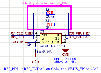

RPI_PIN11
Video DAC output (CM4) / USB3 VBUS enable (CM5)

Some configuration can be done by switching SW1 DIP switch bits. Detailed switch bit descriptions is given in Table 6.
Table 6. DIP switch configuration bits
Bit
Description
1
RPI_nRPIBOOT
RPi boot source:
OFF: RPI boots from eMMC/uSD (default).
ON: Booting from eMMC will be stopped and booting will be transferred to RPi boot which is via USB.
2
USB_C_RPI1
RPi USB 2.0 port mux control:
OFF: RPi USB is connected to USB hub (default).
ON: RPi USB is connected to USB C connector.
3
USB_PD_I
USB C PD current configuration:
OFF: I=2.5A (default).
ON: I=1.5A.
4
EN_CM5_USB3
Dual USB socket source:
OFF: connected to USB 2.0 hub (for CM4).
ON: connected to CM5 USB3.0 lines (for CM5).

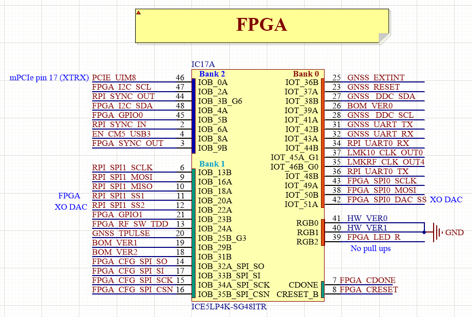

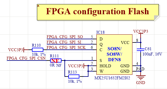

FPGA configuration
LimePSB RPCM board houses Lattice Semiconductor ICE40 Ultra family FPGA ICE5LP4K. It can be copnfigured by RPI CM4/5 (RPI_SPI0) or by external source (JTAG). By default FPGA is set to SPI slave mode and PRi module is in master mode to configure it during boot up. Also FPGA can be set to SPI master mode (FPGA_CFG) while CM4/5 (RPI_SPI0) is disconnected. In this case FPGA configuration information is stored in flash IC19 (NF). Hardware configuration for both modes are shown table 7.
Table 7. FPGA configuration mode selection
Component id
Slave SPI
Master SPI
R103
populate
populate
R104
remove
populate
R105
populate
remove
R106
remove
populate
R107
populate
remove
R108
populate
populate
R109
populate
remove
R111
remove
populate

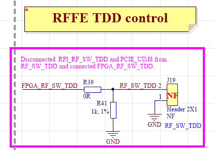

A single control signal (RF_SW_TDD) is used to control all RF switches simultaneously for both A and B channels to change between TDD and FDD modes as shown in Table 9.
Table 9. RF path truth table
Control signal (RF_SW_TDD)
TRXA/B connected to
RXA/B connected to
Low
TXA/B_IN
RXA/B_OUT
High
RXA/B_OUT
NC
By default RF switches may be controlled from FPGA pin 13 (via resistor R39). Optional control source may be RFFE TDD control header (J19).

USB Subsystem
LimePSB RPCM contains USB2.0 hub, over current protection, type-C, double type-A sockets and headers. USB sockets and header has independent current limit power switches. The USB subsystem diagram is as shown in Figure 7.
../_images/LimePSB-RPCM_v1.3_diagrams_USB.png
Figure 7 LimePSB RPCM v1.3 USB subsystem diagram
Main LimePSB RPCM board USB subsystem components:
  • USB type-C socket (J26) is primarily used as LimePSB-RPCM one of power supply sources (for more information check section 2.15 Power Distribution). To enable RPi USB boot mount nRPIBOOT jumper on J12 pins 1-2 and mount a jumper on header J27 to switch Raspberry Pi USB from USB hub to USB C (more information check section 2.2 Raspberry Pi CM4/5 Configuration).
  • USB type-A dual sockets (J30) may be used to connect USB peripherals to the Raspberry Pi CM4/5. Top socket is USB 3.0 if CM5 is used.
  • USB type-A dual socket (J30) and header (J28) have over current protection. Current limit is set to 600 mA. Both sockets share same protection circuitry so if one of them tries to draw more current both sockets will be disabled. Header has it is own separate over current protection.
  • USB2.0 hub USB2517 (IC19) USB 2.0 hub expands Raspberry Pi CM4/5 USB port to dual USB socket (J30), header (J28) and mPCIe (J3). For more information check Table 12.
Table 12. USB2.0 (IC20) Hub signals
Pin
Pin name
Function [7]
Connector ID
59/58
USBUP_DP/ USBUP_DM
Root port
USB_HUB_D0_P/ USB_HUB_D0_N
Connected to CM4/5 USB via USB switch
2/1
USBDN1_DP/ USBDN1_DM
Downstream port
USB_HUB_D1_P/ USB_HUB_D1_N
J3 (mPCIe)
4/3
USBDN2_DP/ USBDN2_DM
Downstream port
USB_HUB_D2_P/ USB_HUB_D2_N
J30 (bottom)
7/6
USBDN3_DP/ USBDN3_DM
Downstream port
USB_HUB_D3_P/ USB_HUB_D3_N
J28 (pins 3/5)
9/8
USBDN4_DP/ USBDN4_DM
Downstream port
USB_HUB_D4_P/ USB_HUB_D4_N
J30 (top)
12/11
USBDN5_DP/ USBDN5_DM
Downstream port
USB_HUB_D5_P/ USB_HUB_D5_N
J28 (pins 8/4)
54/53
USBDN6_DP/ USBDN6_DM
Downstream port
USB_HUB_D6_P/ USB_HUB_D5_N
IC40 (GNSS)
56/55
USBDN7_DP/ USBDN7_DM
Downstream port
NC
NC

SPI, I2C, UART Interfaces
LimePSB-RPCM features multiple low speed interfaces like SPI, I2C, UART. LimePSB-RPCM low speed interfaces signal names, I/O standards are listed in table 14.
Table 14. CM4/5 low speed interfaces pins
Interface
CM4/5 pin
I/O standard
Comment
SPI0
RPI_SPI0_SCLK
38 (GPIO11)
3.3V
Serial Clock (CM4/5 output)
RPI_SPI0_MOSI
44 (GPIO10)
3.3V
Data (CM4/5 output)
RPI_SPI0_MISO
40 (GPIO9)
3.3V
Data (CM4/5 input)
RPI_SPI0_SS0
39 (GPIO8)
3.3V
IC17 FPGA config SPI slave select (CM4/5 output)
RPI_SPI0_SS1
37 (GPIO7)
3.3V
IC34 phase detector SPI slave select (CM4/5 output)
SPI1
RPI_SPI1_SCLK
25 (GPIO21)
3.3V
RPI_SPI1_MOSI
27 (GPIO20)
3.3V
Data (CM4/5 output)
RPI_SPI1_MISO
26 (GPIO19)
3.3V
Data (CM4/5 input)
RPI_SPI1_SS0
49 (GPIO18)
3.3V
IC6 ADC SPI slave select (CM4/5 output)
RPI_SPI1_SS1
50 (GPIO17)
3.3V
IC17 FPGA SPI slave select (CM4/5 output)
RPI_SPI1_SS2
29 (GPIO16)
3.3V
I2C0
RPI_I2C0_SCL
80
3.3V
RPI_I2C0_SDA
82
3.3V
Data (CM4/5 input/output)
UART0
RPI_UART0_RX
51 (GPIO15)
3.3V
Data (CM4/5 input)
RPI_UART0_TX
55 (GPIO14)
3.3V
Data (CM4/5 output)
FPGA low speed interfaces signal names, I/O standards are listed in table 15.
Table 15. FPGA low speed interfaces pins
Interface
FPGA pin
I/O standard
Comment
CFG
FPGA_CFG_SCK
15 (IOB_34A)
3.3V
Serial Clock (FPGA output)
FPGA_CFG_SO
14 (IOB_32A)
3.3V
Data (FPGA input)
FPGA_CFG_SI
17 (IOB_33B)
3.3V
Data (FPGA output)
FPGA_CFG_CSN
16 (IOB_35B)
3.3V
IC18 flash (FPGA output) CM4/5 output?
SPI0
FPGA_SPI0_SCLK
43 (IOT_49A)
3.3V
FPGA_SPI0_MOSI
38 (IOT_50B)
3.3V
Data (FPGA output)

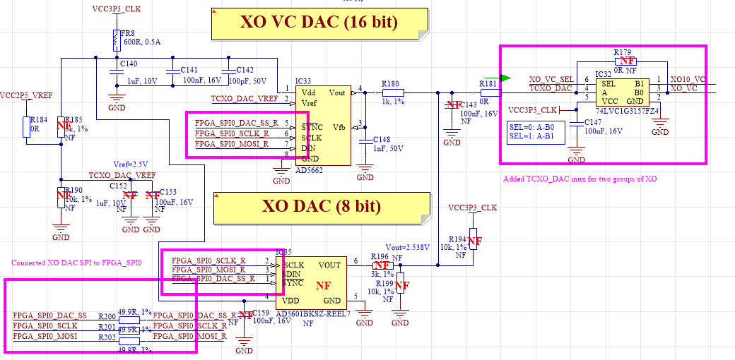

FPGA_SPI0_DAC_SS
42 (IOT_51A)
3.3V
IC33 / IC35 DAC SPI slave select (FPGA output)
I2C0
FPGA_I2C0_SCL
47 (IOB_2A)
3.3V
FPGA_I2C0_SDA
48 (IOB_4A)
3.3V
Data (FPGA input/output)
UART
GNSS_UART_RX
51 (GPIO15)
3.3V
Data (FPGA input)
GNSS_UART_TX
55 (GPIO14)
3.3V
Data (FPGA output)

IC12
FAN controller
0 1 0 1 1 1 1 R/W
3.3V
EMC2301

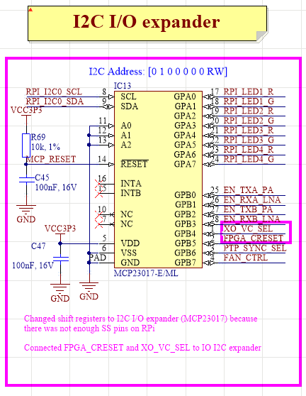

IC13
I/O expander
0 1 0 0 0 0 0 R/W
3.3V
MCP23017-E/ML

GPIO Connector
Some Raspberry Pi Compute Module 4/5 GPIOs are connected to 20 pin 0.1” J10 header. Several pins of this connector are dedicated for power (1 pin for 3.3 V and 2 pins for 5V). GPIO header pins (J10) and additional information is given in table 20.
Table 20. Raspberry Pi CM4/5 GPIO header (J10) pins
Connector pin
CM4/5 pin
I/O standard
Comment
1
VCC3P3
3.3V
3.3V power rail
2
VCC5P0
5.0V
5.0V power rail
3
RPI_GPIO22
GPIO22
3.3V
General purpose
4
VCC5P0
5.0V
5.0V power rail
5
RPI_GPIO27
GPIO27
3.3V
General purpose
6
GND
Ground (0V)
7
GND
Ground (0V)
8
RPI_UART0_TX
GPIO14
3.3V
General purpose configured as UART output
9
RPI_SPI0_MOSI
GPIO10
3.3V
General purpose configured as SPI output
10
RPI_UART0_RX
GPIO15
3.3V
General purpose configured as UART input
11
RPI_SPI0_MISO
GPIO9
3.3V
General purpose configured as SPI input
12
FPGA_GPIO0
FPGA 45 pin (IOB_5B)
13
RPI_SPI0_SCLK
GPIO11
3.3V
General purpose configured as SPI clock
14
FPGA_GPIO1
FPGA 21 pin (IOB_23B)
15
RPI_GPIO2
GPIO2
3.3V
General purpose
16
RPI_GPIO4
GPIO4
3.3V
General purpose
17
RPI_ID_SD
ID_SD
3.3V
I2C interface SDfor HATs (ID EEPROM)
18
RPI_ID_SC
ID_SC
3.3V
I2C interface SC for HATs (ID EEPROM)
19
GND
Ground (0V)
20
GND
Ground (0V)
Board Temperature Control
LimePSB-RPCM board has two dedicated 0.1” pitch headers J23 and J24 for fans. Header J23 is standard 4-pin fan header while J24 is 2-pin header. Fan control voltage is VCC_IN (12V) by default, but it may be changed to 3.3V or 5V by resistors. Fan power may be controlled from I/O expander (IC13) output GPB7 (FAN_CTRL), directly from temperature sensor IC7 pin 3 (LM75_OS) or by FAN controller (IC10) (default).
4 pin FAN connector (J23) is compatible with 3 pin fans. PWM signal from FAN controller (IC10) can be used to control fan speed by switching MOSFET (VT2) if R90 is fitted (default). If 4 pin fan is used remove R90 and fit R75 to route PWM signal to the connectors 4th pin also fit R84.
Clock Distribution Network
LimePSB-RPCM board clock network comprises of on-board voltage controlled crystal oscillators, phase detector, clock buffers, GNSS receiver, reference clock input and output connectors and clock source selection pin headers.
Board clock distribution block diagram is as shown in figure
../_images/LimePSB-RPCM_v1.3_diagrams_clock.png
Figure 9. LimePSB RPCM v1.3 board clock distribution block diagram
LimePSB-RPCM board distributes reference clock to and from Raspberry Pi Compute Module 4/5, mini PCIe connector and external sources. Clock and PPS signals can be sourced from onboard XOs and GNSS transceiver or another boards via J34 (EXT_SYNC_IN) connector. Also J37 (EXT_SYNC_OUT) connector can be used as clock signal output thus synchronizing multiple systems. Clock path may be configured using jumpers and resistors as described in table 21.
Table 21. LimePSB-RPCM clock signals configuration
Schematic ID
Input signal
Output signal
Description
J38
EXT_SYNC_IN
REF_CLK_IN
Phase detector (IC34) input selection
LMK10_CLK_OUT
J39
SYNC_OUT
PCIE_PPS_IN
PPS signal source selection for mPCIe expansion boards
EXT_SYNC_IN
J40
EXT_SYNC_IN
RPI_SYNC_IN
CM4/5 SYNC_IN synchronization input source selection
PCIE_PPS_OUT
J41
EXT_SYNC_IN
PCIE_UIMC4
Reference clock selection for mPCIE exanpsion board (XTRX)
LMK_CLK_OUT2
J36
RPI_SYNC_OUT
EXT_SYNC_OUT
Synchronization output signal selection
SYNC_OUT
PCIE_PPS_OUT
LMK_CLK_OUT3
J42
RPI_SYNC_OUT

Raspberry Pi Connector Changes
Disconnected PCIE_LED_WWAN from RPi GPIO16 and connected RPI_SPI1_SS2 (XO DAC SS).
Disconnected RPI_RF_SW_TDD from RPi GPIO6 and connected PCIE_LED_WWAN.
Changed SPI interfaces:
  • RPI_SPI0 SS0 changed from XO DA to FPGA CFG
  • RPI_SPI1 SS1 changed from SR to FPGA
  • RPI_SPI1 SS2 connected to XO DAC (GPIO16 to FPGA)
Board SPI interfaces:
  • RPI_SPI0 (3.3V): FPGA CFG (SS0 - GPIO8), ADF (SS1 - GPIO7)
  • RPI_SPI1 (3.3V): ADC (SS0 - GPIO18), FPGA (SS1 - GPIO17), XO DAC (SS2 - GPIO16 to FPGA)
RPI connector schematic changes are shown in Figure 11.
../_images/LimePSB-RPCM_v1.3_RPI_changes.png
Figure 11 Raspberry Pi CM4/5 connector changes
Added bypass option for RPI_PIN11 as shown in Figure 12.
../_images/LimePSB-RPCM_v1.3_RPIMUX_changes.png
Figure 12 RPI_PIN11 analog mux changes

Connected FPGA_GPIO0 and FPGA_GPIO1 to J10 pins 10 and 12 instead GND pins as shown in figure 13.

Changed shift registers to I2C I/O expander (MCP23017) because there was not enough SS pins on RPi.
Connected FPGA_CRESET and XO_VC_SEL to IO I2C expander
New I2C I/O expander schematic is given in Figure 14
../_images/LimePSB-RPCM_v1.3_EXP_changes.png
Figure 14 new I2C I/O expander
Disconnected RPI_RF_SW_TDD and PCIE_UIM8 from RF_SW_TDD and connected FPGA_RF_SW_TDD. Resulting RFFE TDD control schematic is shown in Figure 15.
../_images/LimePSB-RPCM_v1.3_TDD_changes.png
Figure 15 RFFE TDD control changes
Corrected FAN controller I2C address note.
Added EMC2301 CLK pull up for fan default drive setting decode.
Added EMC2301 PWM pull up.
../_images/LimePSB-RPCM_v1.3_FAN_changes.png
Figure 16 Fan controller changes
FPGA changes
Added Lattice ICE5LP4K-SG48ITR FPGA. Schematics are designed for two FPGA configuration modes: Slave SPI (default) and master SPI. Connected GNSS interface, clocks, XO DAC, RPI_SPI1, RPI_I2C0, RPI_UART0, HW_VER, BOM_VER, FPGA_GPIO, TDD control and other lines to FPGA as shown in Figure 17.
../_images/LimePSB-RPCM_v1.3_FPGA_changes.png
Figure 17 New FPGA schematics

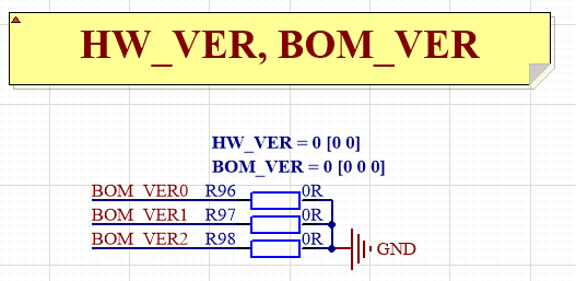

Added hard ware (HW_VER) and Bill of materials (BOM_VER) version indentification to schemtics as shown in Figure 18.
../_images/LimePSB-RPCM_v1.3_BOM_changes.png
Figure 18 New HW_VER and BOM_VER schematics
Added new power rails (VCC1P2 and VCC2P5) for FPGA. FPGA power schematics are shown in Figure 19.
../_images/LimePSB-RPCM_v1.3_FPGAPOW_changes.png
Figure 19 New FPGA power schematics
Added configuration flash for FPGA as shown in Figure 20.
../_images/LimePSB-RPCM_v1.3_FLASH_changes.png
Figure 20 New FPGA flash schematics
USB changes
Replaced USB 2.0 header (J27) with USB 3.0 header. Removed one of the USB 2.0 port and added USB 3.0 port. Renamed USB header power rail to VCC5P0_USB3H. New USB header shcemtics are given in Figure 21.
../_images/LimePSB-RPCM_v1.3_USBHDR_changes.png
Figure 21 USB header changes
Replaced USB 3.0 port from dual USB top socket (J30) with a USB 2.0 port. Renamed dual USB as shown in Figure 22.
../_images/LimePSB-RPCM_v1.3_USBSOC_changes.png
Figure 22 USB socket changes
From now on when CM4 is used all socket ports are USB2.0. When CM5 is used only bottom port is USB3.0.
Renamed dual USB top socket port signals prefixes to USB3H_1, since they are now connected to USB 3.0 header.
../_images/LimePSB-RPCM_v1.3_USBSW_changes.png
Figure 23 USB switch changes
Connected GNSS USB to USB HUB port 6 via 0R. Swapped some ports between USB header and socket. Changed USB2.0 hub OCS and PRTPWR lines connections according to swapped USB ports between USB header and socket. New USB hub schamtics are given in Figure 24.
../_images/LimePSB-RPCM_v1.3_USBHUB_changes.png
Figure 24 USB hub changes
Clock changes
Renamed clock buffer signals:
  • LMK_CLK_OUTn to LMKRF_CLK_OUTn
  • VCC3P3_LMK to VCC3P3_LMKRF
  • VCC3P3_LMK_VDDO to VCC3P3_LMKRF_VDDO
Resulting clock buffer schematics are shown in Figure 25.
../_images/LimePSB-RPCM_v1.3_RFREF_changes.png
Figure 25 Reference clock buffer changes
Connected XO DAC SPI to FPGA_SPI0. Added TCXO_DAC mux for two groups of XOs as shown in Figure 26.
../_images/LimePSB-RPCM_v1.3_DAC_changes.png
Figure 26 XO DAC and mux changes
Added 10 MHz OCXO reference with alternatives and clock buffer.
../_images/LimePSB-RPCM_v1.3_10MHZ_changes.png
Figure 27 XO New 10 MHz reference with clock buffer
Changed EXT_SYNC_OUT header (J36) wit a bigger one. Added new 10 MHz clock LMK10_CLK_OUT3 as one of possible EXT_SYNC_OUT sources.
Added new clock signal SYNC_OUT that can be sourced by RPI_SYNC_OUT or FPGA_SYNC_OUT. Added new header (J42) for RPI_SYNC_OUT/FPGA_SYNC_OUT path selection to SYNC_OUT.
Changed REF_CLK_IN header (J38) input signal RPI_SYNC_OUT to LMK10_CLK_OUT2.
Changed PCIE_PPS_IN header (J39) input signal RPI_SYNC_OUT to SYNC_OUT.
New clock schematics are given in Figure 28.
../_images/LimePSB-RPCM_v1.3_CLKJMP_changes.png
Figure 28 Clock config jumpers and connectors changes

Power changes
Added new LDOs for VCC3P3_CLK2, VCC1P2 and VCC2P5
../_images/LimePSB-RPCM_v1.3_PWR_changes.png
Figure 30 New GNSS receiver
