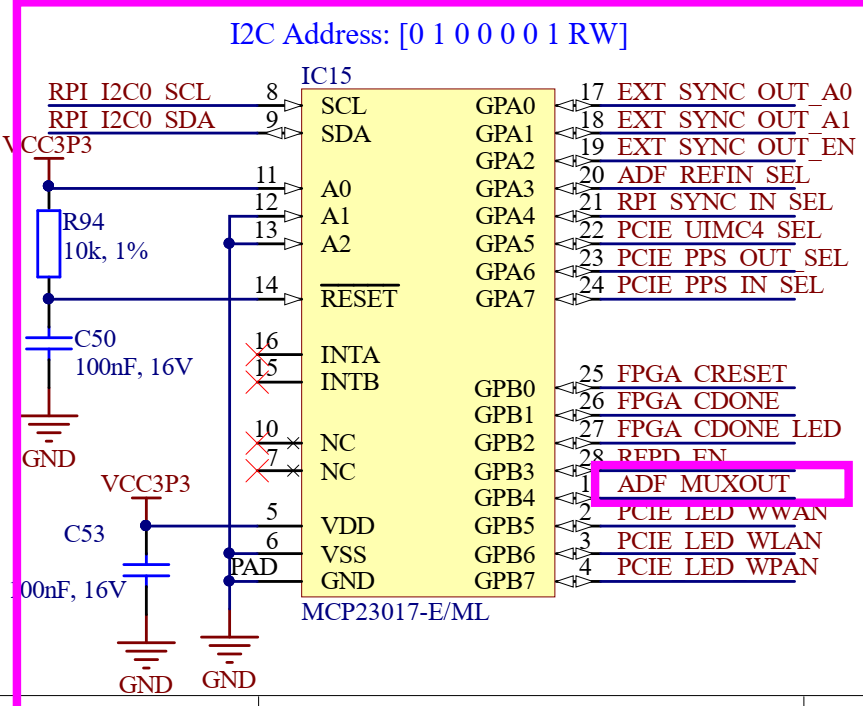

IC12, IC15 |
IC |
I²C I/O expander |

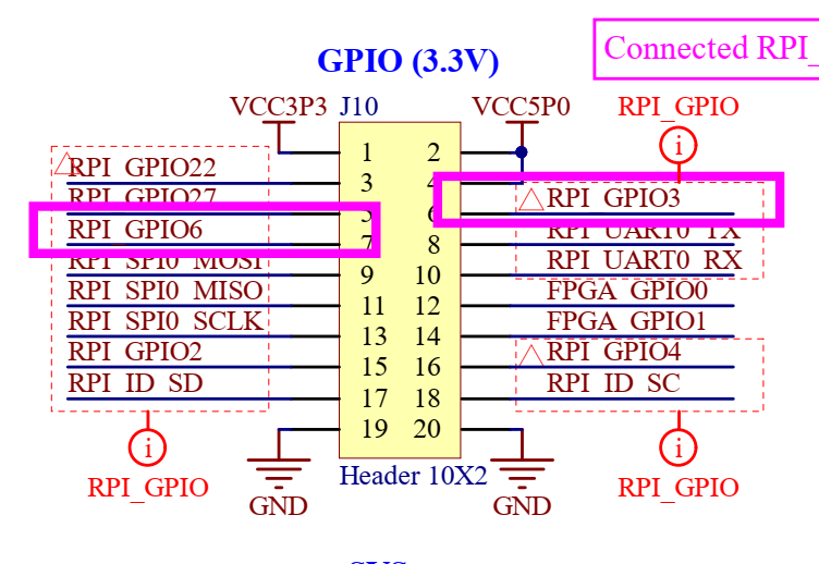

J10 |
Header |
20-pin CM4 GPIO header |

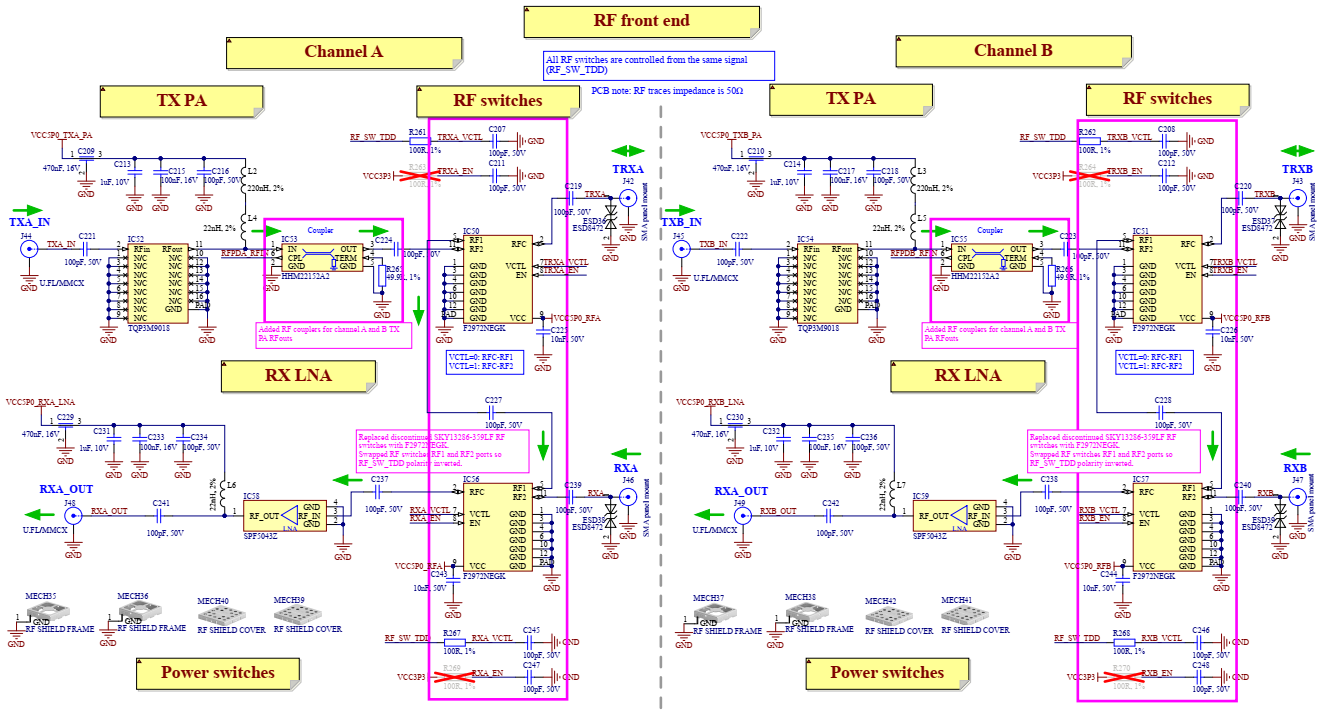

RF front end |
IC52, IC54 |
IC |
PA TQP3M9018 |
IC58, IC59 |
IC |
LNA SPF5043Z |
IC50, IC51, IC56, IC57 |
IC |
RF switch F2972NEGK |
IC53, IC55 |
IC |
Coupler HHM22152A2 |

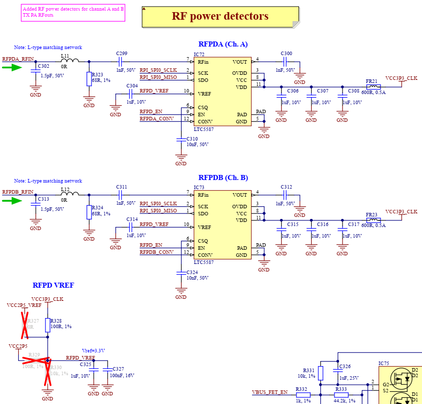

IC72, IC73 |
IC |
RF power detector LTC5587 |

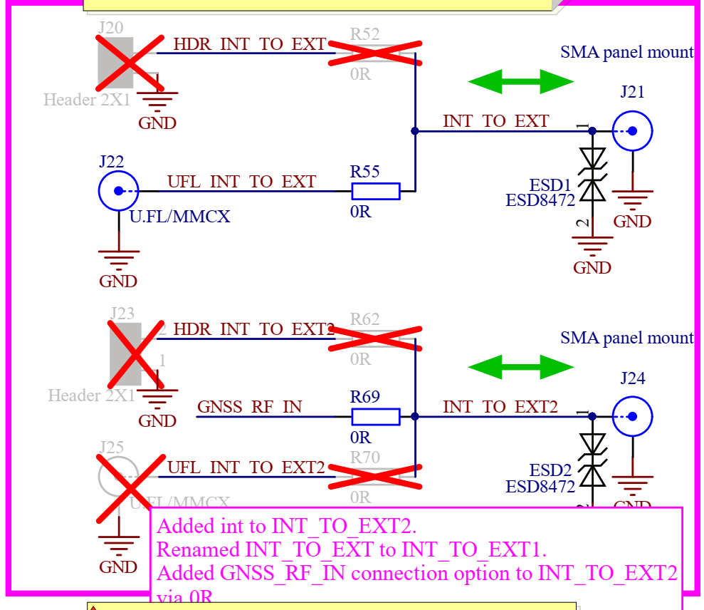

J20/J22, J23/25, J21, J24 |
Multiple |
Internal U.FL connectors J20/J22, J23/J25 to external SMA J21, J24 |
J41 |
U.FL connector |
External GNSS antenna |

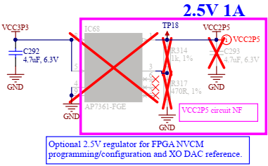

IC68 |
IC |
Linear regulator AP7361-FGE (2.5V rail) |

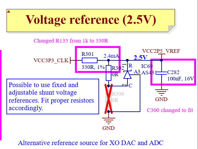

IC69 |
IC |
Voltage reference AS431ANTR-G1 (2.5V rail) |

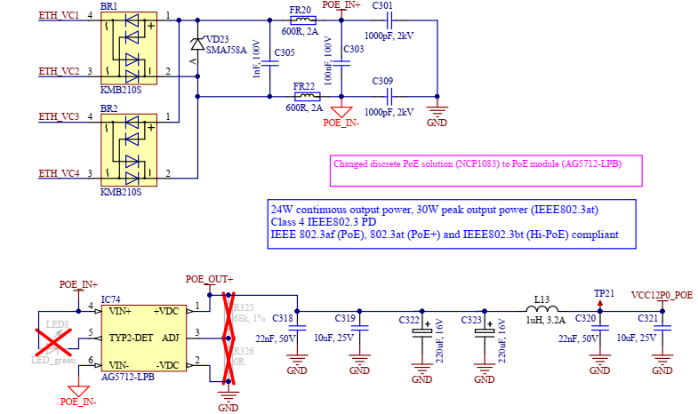

IC74 |
IC |
Power over Ethernet controller AG5712-LPB |

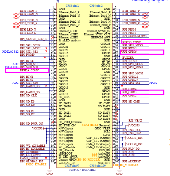

Raspberry CM4/5 Connector¶
LimePSB RPCM board is designed to use Raspberry Pi CM4/5 as a host computer. Raspberry Pi CM4/5L version without eMMC Flash memory is also supported. Board to board connectors (J1 and J2) are used to connect CM4/5 to the LimePSB RPCM board. Connector pinout, CM4 and CM5 signals and schematic signal names are listed and described in Table 2.
CM4 Pin |
CM4 reference |
Schematic signal name |
Description [1] |
1 |
GND |
GND |
Ground (0V) |
2 |
GND |
GND |
Ground (0V) |
3 |
Ethernet_Pair3_P |
ETH_TRD3_P |
Ethernet pair 3 positive |
4 |
Ethernet_Pair1_P |
ETH_TRD1_P |
Ethernet pair 1 positive |
5 |
Ethernet_Pair3_N |
ETH_TRD3_N |
Ethernet pair 3 negative |
6 |
Ethernet_Pair1_N |
ETH_TRD1_N |
Ethernet pair 1 negative |
7 |
GND |
GND |
Ground (0V) |
8 |
GND |
GND |
Ground (0V) |
9 |
Ethernet_Pair2_N |
ETH_TRD2_N |
Ethernet pair 2 negative |
10 |
Ethernet_Pair0_N |
ETH_TRD0_N |
Ethernet pair 0 negative |
11 |
Ethernet_Pair2_P |
ETH_TRD2_P |
Ethernet pair 2 positive |
12 |
Ethernet_Pair0_P |
ETH_TRD0_P |
Ethernet pair 0 positive |
13 |
GND |
GND |
Ground (0V) |
14 |
GND |
GND |
Ground (0V) |
15 |
Ethernet_nLED3 |
ETH_LED_Y |
Ethernet activity indicator |
16 |
Ethernet_SYNC_IN |
RPI_PIN16 |
IEEE1588 SYNC Input |
17 |
Ethernet_nLED2 |
ETH_LED_G |
Ethernet speed indicator |
18 |
Ethernet_SYNC_OUT |
RPI_PIN18 |
IEEE1588 SYNC Output |
19 |
Ethernet_nLED1 |
NC |
20 |
EEPROM_nWP |
RPI_EEPROM_nWP |
EEPROM write protect |
21 |
Pi_nLED_Activity |
RPI_STATUS_LED_R |
Pi activity LED |
22 |
GND |
GND |
Ground (0V) |
23 |
GND |
GND |
Ground (0V) |
24 |
GPIO26 |
RFPDB_CONV |
General purpose |
25 |
GPIO21 |
RPI_SPI1_SCLK |
General purpose |
26 |
GPIO19 |
RPI_SPI1_MISO |
General purpose |
27 |
GPIO20 |
RPI_SPI1_MOSI |
General purpose |
28 |
GPIO13 |
RPI_PWM1 |
General purpose |
29 |
GPIO16 |
RPI_SPI1_SS2 |
General purpose |
30 |
GPIO6 |
RPI_GPIO6 |
General purpose |
31 |
GPIO12 |
RPI_PWM0 |
General purpose |
32 |
GND |
GND |
Ground (0V) |
33 |
GND |
GND |
Ground (0V) |
34 |
GPIO5 |
BUZZER |
General purpose |
35 |
ID_SC |
RPI_ID_SC |
BCM2711 GPIO 1 |
36 |
ID_SD |
RPI_ID_SD |
BCM2711 GPIO 0 |
37 |
GPIO7 |
RPI_SPI0_SS1 |
General purpose |
38 |
GPIO11 |
RPI_SPI0_SCLK |
General purpose |
39 |
GPIO8 |
RPI_SPI0_SS0 |
General purpose |
40 |
GPIO9 |
RPI_SPI0_MISO |
General purpose |
41 |
GPIO25 |
RFPDA_CONV |
General purpose |
42 |
GND |
GND |
Ground (0V) |
43 |
GND |
GND |
Ground (0V) |
44 |
GPIO10 |
RPI_SPI0_MOSI |
General purpose |
45 |
GPIO24 |
RPI_BTN1 |
General purpose |
46 |
GPIO22 |
RPI_GPIO22 |
General purpose |
47 |
GPIO23 |
RPI_BTN2 |
General purpose |
48 |
GPIO27 |
RPI_GPIO27 |
General purpose |
49 |
GPIO18 |
RPI_SPI1_SS0 |
General purpose |
50 |
GPIO17 |
RPI_SPI1_SS1 |
General purpose |
51 |
GPIO15 |
RPI_UART0_RX |
General purpose |
52 |
GND |
GND |
Ground (0V) |
53 |
GND |
GND |
Ground (0V) |
54 |
GPIO4 |
RPI_GPIO4 |
General purpose |
55 |
GPIO14 |
RPI_UART0_TX |
General purpose |
56 |
GPIO3 |
RPI_GPIO3 |
General purpose |
57 |
SD_CLK |
RPI_SD_CLK |
SD card clock signal |
58 |
GPIO2 |
RPI_GPIO2 |
General purpose |
59 |
GND |
GND |
Ground (0V) |
60 |
GND |
GND |
Ground (0V) |
61 |
SD_DAT3 |
RPI_SD_D3 |
SD card/eMMC Data3 signal |
62 |
SD_CMD |

CM4 Pin |
CM4 reference |
Description [2] |
1 |
GND |
GND |
Ground (0V) |
2 |
GND |
GND |
Ground (0V) |
3 |
Ethernet_Pair3_P |
ETH_TRD3_P |
4 |
Ethernet_Pair1_P |
ETH_TRD1_P |
5 |
Ethernet_Pair3_N |
ETH_TRD3_N |
6 |
Ethernet_Pair1_N |
ETH_TRD1_N |
7 |
GND |
GND |
Ground (0V) |
8 |
GND |
GND |
Ground (0V) |
9 |
Ethernet_Pair2_N |
ETH_TRD2_N |
10 |
Ethernet_Pair0_N |
ETH_TRD0_N |
11 |
Ethernet_Pair2_P |
ETH_TRD2_P |
12 |
Ethernet_Pair0_P |
ETH_TRD0_P |
13 |
GND |
GND |
Ground (0V) |
14 |
GND |
GND |
Ground (0V) |
15 |
Ethernet_nLED3 |
ETH_LED_Y |
16 |
Fan_Tacho |
RPI_PIN16 |
Fan Tacho Input pin |
17 |
Ethernet_nLED2 |
ETH_LED_G |
18 |
Ethernet_SYNC_OUT |
RPI_PIN18 |
19 |
Fan_PWM |
NC |
Open drain output |
20 |
EEPROM_nWP |
RPI_EEPROM_nWP |
21 |
Pi_nLED_Activity |
RPI_STATUS_LED_R |
Pi activity LED |
22 |
GND |
GND |
Ground (0V) |
23 |
GND |
GND |
Ground (0V) |
24 |
GPIO26 |
RFPDB_CONV |
General purpose |
25 |
GPIO21 |
RPI_SPI1_SCLK |
General purpose |
26 |
GPIO19 |
RPI_SPI1_MISO |
General purpose |
27 |
GPIO20 |
RPI_SPI1_MOSI |
General purpose |
28 |
GPIO13 |
RPI_PWM1 |
General purpose |
29 |
GPIO16 |
PRI_SPI1_SS2 |
General purpose |
30 |
GPIO6 |
RPI_GPIO6 |
General purpose |
31 |
GPIO12 |
RPI_PWM0 |
General purpose |
32 |
GND |
GND |
Ground (0V) |
33 |
GND |
GND |
Ground (0V) |
34 |
GPIO5 |
BUZZER |
General purpose |
35 |
ID_SC |
RPI_ID_SC |
BCM2711 GPIO 1 |
36 |
ID_SD |
RPI_ID_SD |
BCM2711 GPIO 0 |
37 |
GPIO7 |
RPI_SPI0_SS1 |
General purpose |
38 |
GPIO11 |
RPI_SPI0_SCLK |
General purpose |
39 |
GPIO8 |
RPI_SPI0_SS0 |
General purpose |
40 |
GPIO9 |
RPI_SPI0_MISO |
General purpose |
41 |
GPIO25 |
RFPDA_CONV |
General purpose |
42 |
GND |
GND |
Ground (0V) |
43 |
GND |
GND |
Ground (0V) |
44 |
GPIO10 |
RPI_SPI0_MOSI |
General purpose |
45 |
GPIO24 |
RPI_BTN1 |
General purpose |
46 |
GPIO22 |
RPI_GPIO22 |
General purpose |
47 |
GPIO23 |
RPI_BTN2 |
General purpose |
48 |
GPIO27 |
RPI_GPIO27 |
General purpose |
49 |
GPIO18 |
RPI_SPI1_SS0 |
General purpose |
50 |
GPIO17 |
RPI_SPI1_SS1 |
General purpose |
51 |
GPIO15 |
RPI_UART0_RX |
General purpose |
52 |
GND |
GND |
Ground (0V) |
53 |
GND |
GND |
Ground (0V) |
54 |
GPIO4 |
RPI_GPIO4 |
General purpose |
55 |
GPIO14 |
RPI_UART0_TX |
General purpose |
56 |
GPIO3 |
RPI_GPIO3 |
General purpose |
57 |
SD_CLK |
RPI_SD_CLK |
58 |
GPIO2 |
RPI_GPIO2 |
General purpose |
59 |
GND |
GND |
Ground (0V) |
60 |
GND |
GND |
Ground (0V) |
61 |
SD_DAT3 |
RPI_SD_D3 |
62 |
SD_CMD |
RPI_SD_CMD |
SD card/eMMC Command signal |
63 |
SD_DAT0 |
RPI_SD_D0 |
SD card/eMMC Data0 signal |
64 |
SD_DAT5 |
NC |
SD card/eMMC Data5 signal |
65 |
GND |
GND |
Ground (0V) |
66 |
GND |
GND |
Ground (0V) |
67 |
SD_DAT1 |
RPI_SD_D1 |
SD card/eMMC Data1 signal |
68 |
SD_DAT4 |
NC |
SD card/eMMC Data4 signal |
69 |
SD_DAT2 |
RPI_SD_D2 |
SD card/eMMC Data2 signal |

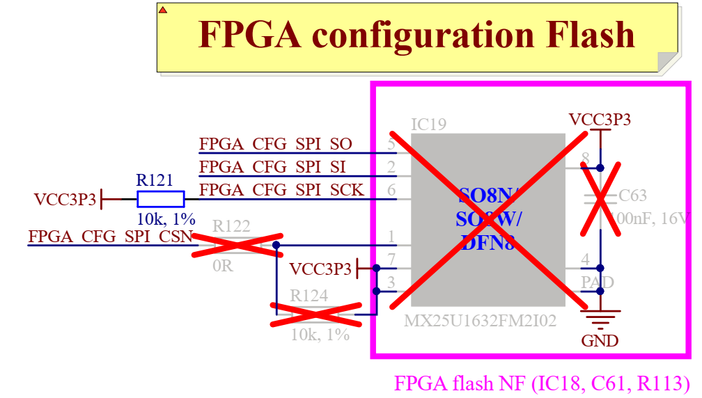

FPGA configuration¶
LimePSB RPCM board houses Lattice Semiconductor ICE40 Ultra family FPGA ICE5LP4K. It can be copnfigured by RPI CM4/5 (RPI_SPI0) or by external source (JTAG). By default FPGA is set to SPI slave mode and PRi module is in master mode to configure it during boot up. Also FPGA can be set to SPI master mode (FPGA_CFG) while CM4/5 (RPI_SPI0) is disconnected. In this case FPGA configuration information is stored in flash IC19 (NF). Hardware configuration for both modes are shown table 7.
Component id |
Slave SPI |
Master SPI |
R113 |
populate |
populate |
R114 |
remove |
populate |
R115 |
populate |
remove |
R116 |
remove |
populate |
R118 |
populate |
remove |
R119 |
populate |
populate |
R120 |
populate |
remove |
R122 |
remove |
populate |
R124 |
remove |
populate |
IC19 |
remove |
populate |
C63 |
remove |
populate |

RF Front End¶
LimePSB RPCM RF path features power amplifiers, low noise amplifiers, SPDT switches, Couplers and power detectors as shown in Figure 6.
Figure 6 LimePSB RPCM v1.4 RFFE diagram¶

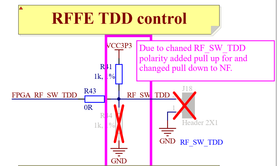

A single control signal (RF_SW_TDD) is used to control all RF switches simultaneously for both A and B channels to change between TDD and FDD modes as shown in Table 9.
Control signal (RF_SW_TDD) |
TRXA/B connected to |
High |
TXA/B_IN |
RXA/B_OUT |
Low |
RXA/B_OUT |
NC |
By default RF switches may be controlled from FPGA pin 13 (via resistor R43). Optional control source may be RFFE TDD control header (J18).
RF path contains two types of connectors: board edge SMA connectors (J42, J43, J46, J47) used for external connections (antennas or cables) and U.FL connectors (J44, J45, J48, 49) used for internal connections (for example to connect to XTRX mini PCIe expansion board).
Signal frequency range of TX and RX paths are listed in Table 10.
Direction |
Frequency range |
TX |
100 MHz - 4 GHz |
RX |
100 MHz - 4 GHz |
More detailed RF path component parameters are given in Table 11.
Component |
Function |
Gain, dB |
Output P1dB, dBm |
NF, dB |
TQP3M9018 |
TX amplifier |
24.6dB (900 MHz) |
22.3dBm (900 MHz) |
0.9dB (900 MHz) |
22dB (1900 MHz) |
22dBm (1950 MHz) |
1.3dB (1950 MHz) |
18.3dB (4000 MHz) |
14.7dBm (4000 MHz) |
2.4dB (4000 MHz) |
SPF5043Z |
RX amplifier |
18.2dB (900 MHz) |
22.6dBm (900 MHz) |
0.8dB (900 MHz) |
12.9dB (1960 MHz) |
22.7dBm (1900 MHz) |
0.8dB (1900 MHz) |
7.0dB (3800 MHz) |
22.8dBm (3800 MHz) |
1.5dB (3800 MHz) |
F2972NEGK |
RF switch |
-0.53dB (1000 MHz) |
38dBm (1800 MHz) |
-0.4dB (2000 MHz) |
-0.55B (6000 MHz) |
Both channels TX PAs TQP3M9018 outputs are coupled by HHM22152A2 (IC53, IC55) to RF power detectors LTC5587 (IC72, IC73). Power detector is connected to RPi CM4/5 SPI (RPI_SPI0). To enable it drive GPPIO expanders EXP1 GPB3 pin high. Information about LTC5587 is available in datasheet. URL: https://www.analog.com/en/products/ltc5587.html

Raspberry Pi Connector Changes¶
Raspberry Pi CM4/5 connector signal changes are:
PCIe LEDs (PCIE_LED_WWAN, PCIE_LED_WLAN, PCIE_LED_WPAN) were moved from RPI connector to I2C GPIO expander number 2 (EXP2).
Newly added RF power detectors (RFPD) were connected to RPI I2C. Their enable signals RFPD1_CONV and RFPD2_CONV were connected to RPI GPIO25 and RPI GPIO26 respectively.
RPI_GPIO3 and RPI_GPIO6 connected to GPIO header (J10).
ADF_MUXOUT moved from RPI_GPIO3 to EXP2 GPB4.
New Raspberry Pi CM4/5 connector changes are shown in Figure 12.
Figure 12 Raspberry Pi CM4/5 connector changes¶

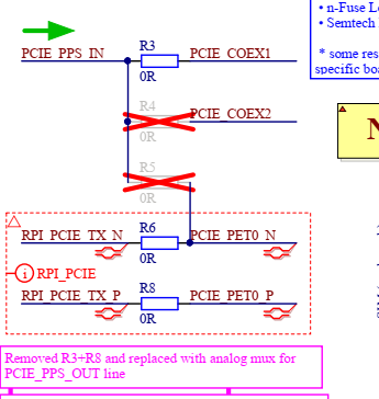

Replaced PCIE_PPS_OUT selection resistors R3 and R8 with analog mux as shown in Figure 14.
Figure 14 mPCIe PCIE_PPS_OUT changes¶

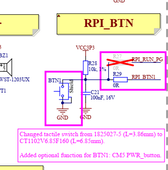

Raspberry button was changed to a part with a longer cap (from 3.86 mm to 6.85 mm). Also added option to change button function to RPI CM5 power on/off as shown in Figure 15.
Figure 15 RPI button changes¶
Changed GPIO header (J10) GND pins 7 and 6 to RPI_GPIO6 and RPI_GPIO3 as shown in Figure 16.
Figure 16 GPIO header (J10) changes¶

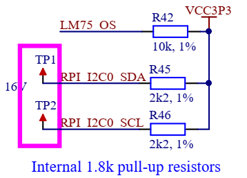

Added test points for Raspberry Pi I2C0 signals (RPI_I2C0_SCL and RPI_I2C0_SDA) as hsown in Figure 17.
Figure 17 I2C signal changes¶
Added new additional I2C IO expander (EXP2). All signals connected to EXP2 are shown in Figure 18.
Figure 18 New GPIO expander (EXP2)¶
New GPIO expander was mainly added to control all new muxes added to clock circuitry. But also some already existing signals were added to it:
FPGA configuration signals (FPGA_CRESET and FPGA_CDONE). FPGA_CRESET signal moved from EXP1 to EXP2. Also added posibility to monitor FPGA_CDONE by adding it to EXP2.
PCIE_LED_WLAN, PCIE_LED_WPAN and PCIE_LED_WWAN were disconnected from RPI connector and connected to EXP2.
ADF_MUXOUT was moved from RPI GPIO3 to EXP2 GPB4.
Added Internal U.FL to external SMA connector (EXT2) and renamed old internal U.FL to external SMA connectors to EXT1. New EXT2 SMA connector can be directly connected to on board GNSS module (IC48) RF_IN pin (default) as shown in Figure 19.
Figure 19 Internal to external connectors changes¶

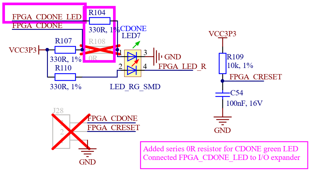

Added FPGA_CDONE signal to EXP2 for monitoring purposes. Also 0R was added as a option to disconnect FPGA LED from FPGA_CDONE signal when monitoring by RPI is required. In this case FPGA LED can still indicate CDONE by EXP2 GPB2 pin (FPGA_CDONE_LED). FPGA LED changes are shown in Figure 20.
Figure 20 FPGA CDONE changes¶
Removed FPGA configuration flash from default BOM as shown in Figure 21.
Figure 21 FPGA flash changes¶

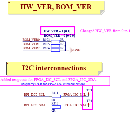

Increased HW_VER from 0 to 1. And added test point for FPGA I2C0 signals (FPGA_I2C0_SCL, FPGA_I2C0_SDA) as shown in Figure 22.
Figure 22 HW_VER and FPGA I2C0 changes¶

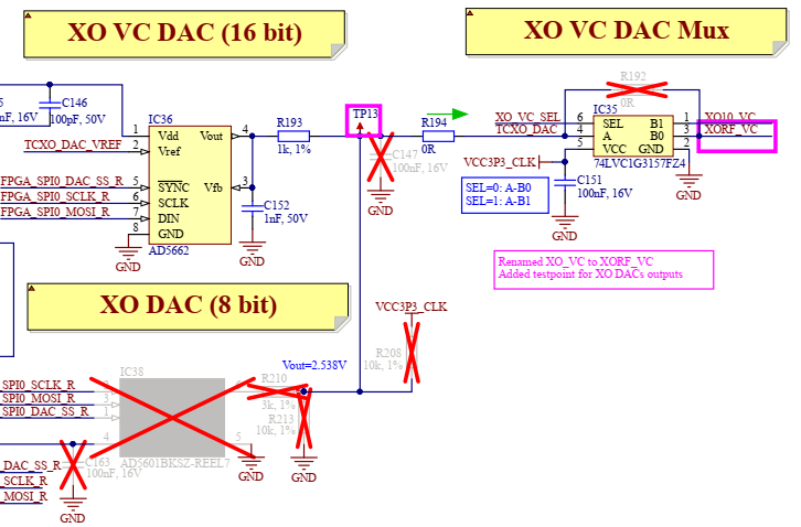

Renamed XO_VC signal name to XORF_VC.
Added testpoint for XO DACs outputs as shown in Figure 23.
Figure 23 XO DAC test point¶

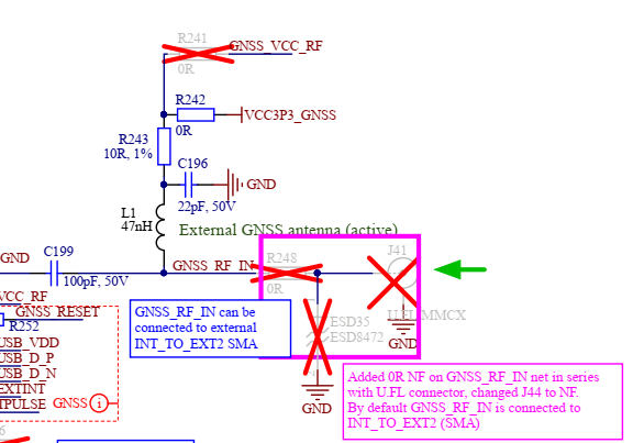

Added 0R NF on GNSS_RF_IN net in series with U.FL connector and changed J44 to NF. By default GNSS_RF_IN is connected to INT_TO_EXT2 (SMA) as shown in Figure 25.
Figure 25 GNSS antenna connection schematics¶

Replaced discontinued SKY13286-359LF RF switches with F2972NEGK. Swapped RF switches RF1 and RF2 ports so RF_SW_TDD polarity inverted.
Added RF couplers (HHM22152A2) for channel A and B TX PA RF outputs.
Mentioned RFFE schematic changes are highlighted in Figure 27.
Figure 27 RFFE changes¶
Due to changed RF_SW_TDD polarity a pull-up resistor was added and pull-down resistor was removed from BOM as shown in Figure 28.
Figure 28 TDD control changes¶
Added RF power detectors (LTC5587) for channel A and B TX PA RF outputs. RF power detector schematic is shown in Figure 29 .
Figure 29 RF power detectors schematics¶

Changed discrete PoE solution (NCP1083) to PoE module (AG5712-LPB). New POE shcmatic is shown in Figure 30.
Figure 30 POE module schematics¶
Removed VCC2P5 circuit from BOM as shown in Figure 31.
Figure 31 VCC2P5 schematics¶
Changed R135 from 1k to 330R as shown in Figure 32.
Figure 32 Voltage reference schematic¶
